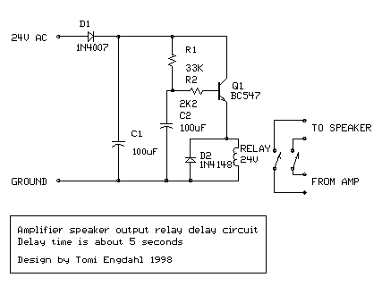

Then I guess the pops are due to those fat 1000uF caps charging. Perhaps you could wire a resistor of, say, >1k in series with the speaker so that the cap charges slowly at power-up, then use relay contacts to short out the resistor after ~2 secs. The contacts would have to be rated for the maximum speaker current.
