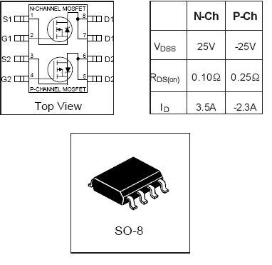

This might suit your complementary MOSFET IC if its FETs are logic-level types with low turn-on threshold voltages :
R1 value depends on the photodiode sensitivity. R3 provides hysteresis feedback. Either could be replaced by a trimmer for set-up.
