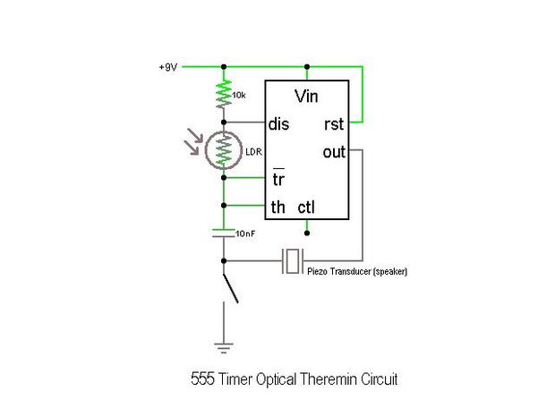

Lately I wanted to built a theremin, but since I'm quite an electronics noob I wanted to keep it very basic and use a 555 timer.
On the internet I read some articles in which LDR's were used, to influence the frequency of the 555 timer and therefor the sound produced by the speaker connected to the output.
