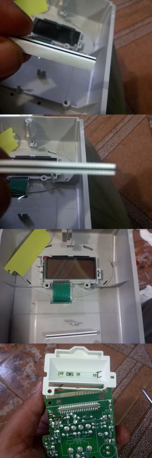

I have a Sharp Carousel microwave model R-330J(S) and cleaned two small cockroaches out of the front display.
Removed, cover, front display/keypad, disconnected all wiring, removed circuit board from front cover, please see the picture below
http://tinypic.com/r/v45jtf/5
I reassembled it but the ribbon (third picture from the top) cable from the keypad has no connector and I assume is placed between the board that it needs to touch and the rubber guard (i.e rubber strip with the carbon looking center line ,first and second pictures from the top) from the display but I can't get it right,,,the problem I didn't take picture before I disassembled it
I tried different scenario but most of all keypad was not working I assume its to do with the way this ribbon connector is sitting, as the keypad was not faulty prior to me pulling it apart.
How can I re-assemble this correctly ? everything else looks fine its just the keypad that isn't working.

I’m pretty sure you already have a new microwave. The ribbon actually sits between the LCD glass and the white and black rubber grommet type strip you described. :)
