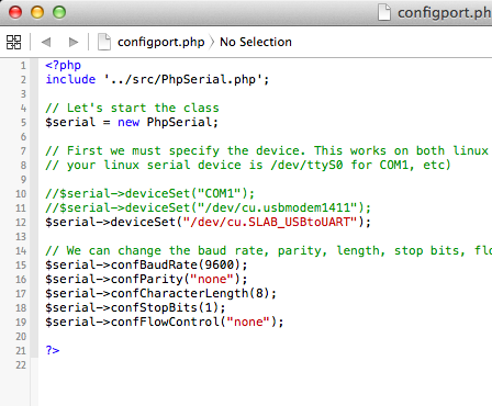

if you really need to do it with a computer, here is a working php example.
extract the attached zip file to your wamp document folder. make sure php is properly configured.
/example folder has text.html and configport.php files.
Serial port set up:
set comm port properties from configport.php. specify the comport to use.

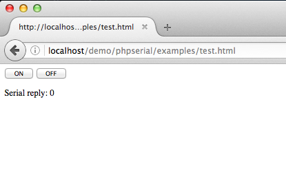

text.html
run in your browser and you will find 2 buttons.
ON button will send "1" on serial port connected. OFF button will send "0"
If TX RX of serial port is shorted (loop back test), you will see 1 or 0 text on the page.
