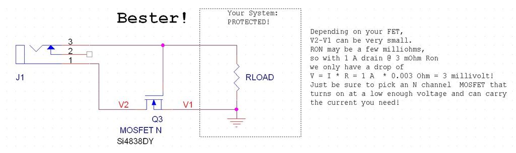

3) Is this the image from above very similar to this image below that I found on this forum?

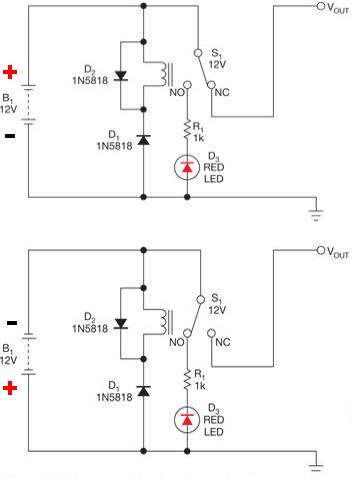

Anyway I thought SDPT relay would be fitting into my application. like this
4) Is this really prefect circuit... no need to improve?
