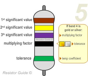

I agree if it was 4-band but I thought 5-band was like this:
except green isn't a valid tolerance band colour so the gold is your tolerance and the green may be a voltage rating or something ... cannot find a reference
trust your meter
EDIT .... OK found this
note the comments ... "If band 4 is gold or silver, then it is the tolerance band and the 5th band is a temp coefficient rating

Beautiful! I wish I had found that on my own. I truly appreciate both of your help in understanding. I trusted my meter, I just wanted to bridge the gap between what it was telling me and my previous understanding. This tidbit seems to be missed by a lot of online resources.

note the 4 band is the multiplier and the 5th band the tolerance ... limited to BN, RD, GLD, SI or BL
the more it's looked into the more crazy it gets, as some manufacturers don't stick by the standards and come up with their own ideas for
band 4 and band 5. eg Mullard
But that chart clearly shows the fourth band gold as a multiplier of 0.1 And I have seen other charts that show green as a 0.5% tolerance.
Bob
yes, that is correct
as I said there are some manufacturer variations
you can see them on that page to link to
