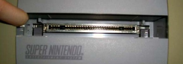

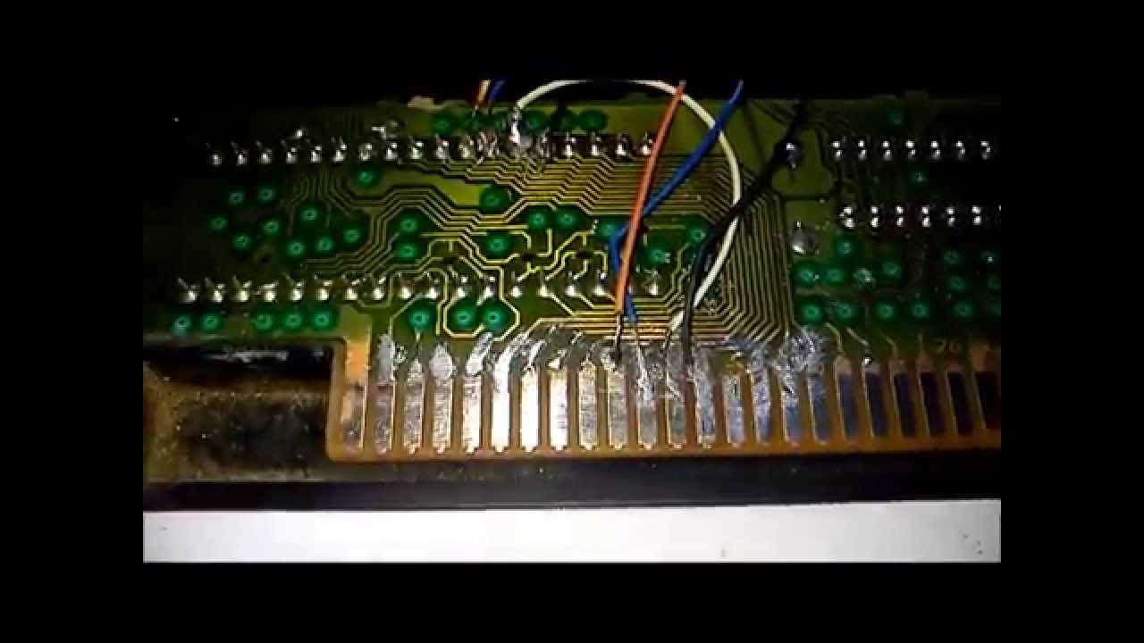

How many years and how many docking and undocking is the durability of the SNes contacts slot and the cartridge contact connectors? they are a golden layer and will wear
The socket and the edge connector that fits into it will both have their own specification for 'number of insertions'.
You will need to seek the data from the socket manufacturer to find out the details.
I do not know the socket and connector manufacturer this information does not exist but what would be the approximate number of inserts to disable the device?
Very difficult to determine. It can depend on HOW the board is inserted more than how many TIMES it's inserted. The manufacturers data will be derived from an automated process (testing procedure) that inserts it 'properly' to get the best possible answer!
In a real world situation you can get some cack-handed idiots ramming it into place at weird angles, too fast, too hard etc which totally destroys the 'expected' life span.
If it looks or actually IS damaged then simply replace it. There's not a lot you can do for the circuit board edge connector other than temporary repairs. I would expect someone, somewhere, does 'bare boards' that you can swap the parts over on to.
The boards themselves may be cheaply made (thin copper, poor tinning, zero gold-plating) or it may be 'genuine' with the best copper, perfect plating etc so as far as getting the information you seek it is pretty much impossible.

1. No, you cannot keep it working for ever. Everything wears out eventually. Either the socket will wear out or the cartridge edge connector will.

1. I have no idea. What condition are they in to begin with? The 'golden layer' is gold-plating and put there to resist corrosion i.e. provide a better contact. As it gets worn away it exposes the material under it. That material is also conductive and will work providing corrosion does not build up on it. Gold plating lasts longer the thicker it is applied but 'thicker means more expensive' so it's usually applied as the thinnest layer they can get away with.
Stop worrying about it. If you don't want it to wear, stop using it. If you want to use it, it's going to wear. Your choice.
