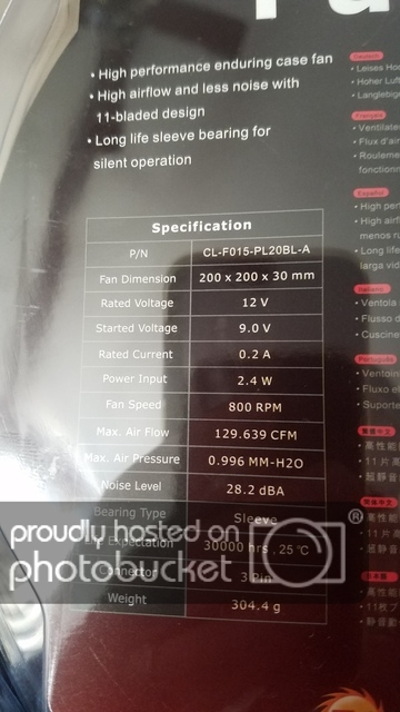

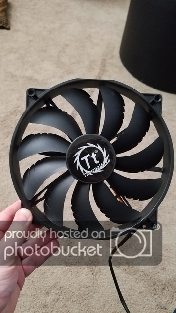

I have two of these computer fans.
and these are its specs

Can I just use an 8 AA battery holder (one for each fan). Second can they be wired together to be turned on by one switch?
Yes and Yes.
To expand the first question, you could, but you´dd probably end up with a pretty short battery life (guessing prehaps 10 hours or less).
The second question should be straight-forward tho, red wire to red wire and black wire to the black one.
You will be feeding both fans from the pack you connected to the switch.. :)
But hooking two (or more) of 8s battery holders together in parallel will give you more fan time in that costume. :)

I am making my son a "flame thrower" for his costume. (he wants to be a flame trooper from Star Wars the Force Awakens. ) I am placing the fans inside some tubes.(mounted to his back) I will have some PFC piping and hosing connected and at the end of the hose will be some yellow and red fabric. What I hope happens is when he pulls the trigger the fans in the tubes will spin up forcing the air through the PVC tubing and hose and cause the flames to flap. Simulating the flame effect.
Perhaps consider the input to the fan is much larger than the output to retain flow of air.
(usually 2.5 times)
May not be important but just a note.
