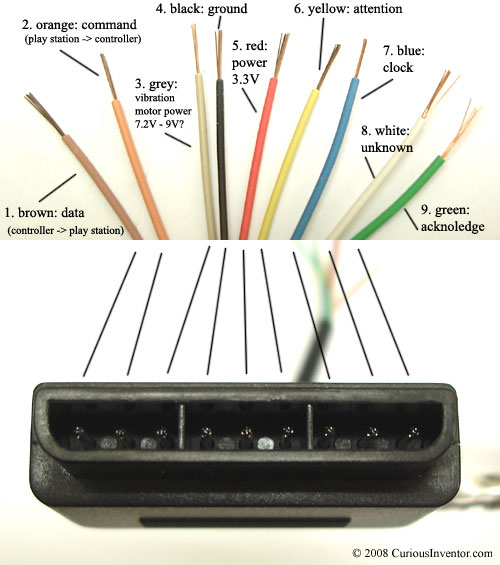

So I really want to try a little project to play some PC games with a spare PS2 controller! I also found this..

Would is be possible to connect any wires from a PS2 controller to that specific controller and make it work?
I am a bit of a novice at electronics but have a basic understanding. Please dont laugh if this seems like a retarded questions haha! But its just a complete shot in the dark! Im also not sure if i would need the steering wheel for this as I just want to plug in the USB transceiver.
