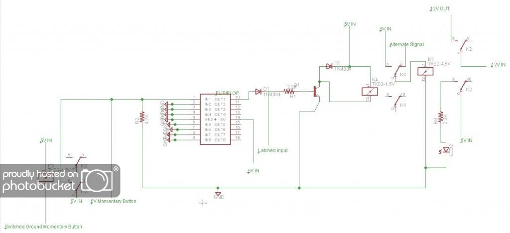

Ive come up with an idea to use an unlatched relay for this situation on the input side of the IC. When the switched ground button is pushed, it will trigger the relay to ouput the 5V to the IC. At startup the IC will not see any voltage and revert to its low (0V) state output.
I'm going to be making this board in Eagle, so the more relays I have to add to worse off I am. The board is getting big and the component prices are adding up.
I'm a Mech E, so that is why I reverted to using a more mechanical approach. Is there any "prettier/more simple" approaches that I could take?

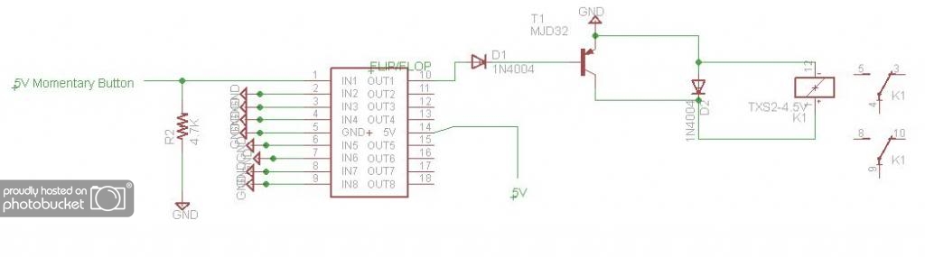

So, I got everything working on my breadboard. I sent the eagle file to OSH park and now the flip/flop isn't functioning properly. When ever i press the Momentary button the circuit actives, however when pressing the button again sometimes the flip/flop reverts back to 0V and other times it just stays at 5V. I disconnected the relay and the flip/ functions normally, so i'm assuming the relay is the culprit.
I measured the current the relay is drawing from the flip/flop to be 20mA, which is below the Max of 25mA for each output pin. So I tried using the transistor like you had mentioned, the only way I could get it to function was to wire it up like in the picture below. The problem persists though, the flip/flop doesn't always revert back to 0V on the second push of the momentary button.
You show ground is up and +5V is down.
Are you from Australia?
Also you show no +5 to the relay.
Check your wiring carefully and compare it to what you used on the breadboard.

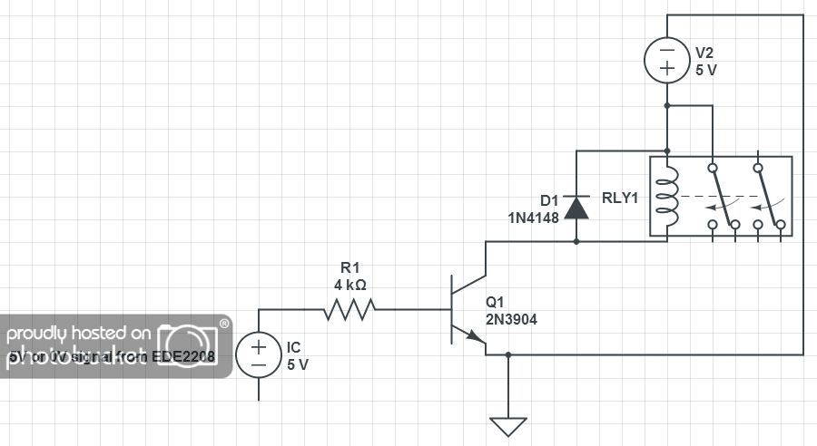

I did some research on NPN transistors last night and I think I've figured it out. My only question is in the schematic below:
a) Is this correctly wired?
b) How does the relay coil get grounded, it seems like the collector would be outputting a voltage signal not a ground signal?
Also would a PN2222A transistor work for this application?

That looks much better. You don't show the -ve of your left voltage source connected to ground, but I trust that is an oversight.
Haha, much better than NJ.
Yeah, I didn't put that in b/c that's the output from the IC, which is just a 5V signal or nothing.
So thinking about the EMF that is created when the relay discharges, is it possible that EMF could influence another relay on the board?
I placed the relays very close together on the board for trace simplicity, which might be the reason the IC only hangs up when I try to switch it for the second time (closing the relay that is after the IC). The input to the IC runs through the leg of a relay, which i'm hoping is what is being influenced by the post IC relay.
Is this possible, if so would there be any other solutions besides physically moving the relays?
However it's still ground references and it would be important that the ground for that chip's power supply connections was common to this circuit.
No.
The relay won't be affected, but the chip might. However this would only happen if you didn't have the diode connected, or maybe if you had it around the wrong way (that would prevent the relay from operating and potentially damage the chip)
I'm sure another solution is the only solution.
Perhaps you can post images of both sides of your board so we can check it just in case you've made a silly mistake.
Sharp, clear photos so we can see markings. Taken in diffused light. Outside in shade is often best. NO flash!
