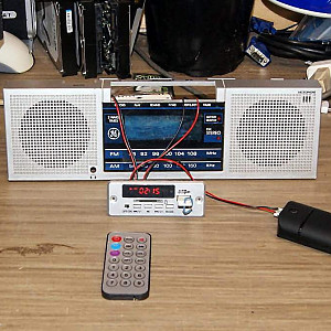

I was intrigued by the panel mount modules that are on eBay and other sites so I ordered a "5V MP3 Player Decoder Board LCD Screen Amplifier 3W*2 Music Player USB FM Radio" with a vague idea about bolting a pair of old computer speakers together, somehow attaching it and using USB power banks to power it.
By the time it arrived I had at least had more time to think about what to do with it. It would be ideal for replacing the electronics in an old portable radio but unfortunately the closest thing I had was an old clock radio cassette recorder combination and it was too big. But it did have 2 little speakers that matched. The first thing to do was test it so I pulled the front panel off of the donor radio, connected the module its speakers and hooked it up to one of the power banks I bought to power it.
My biggest concerns were whether it would play long MP3s (the programs are 1-4 hours long) and turn it off in the middle of a program and start at the same point later. I determined that it had no problem with long MP3s and as long as I pause it before turning it off (or disconnecting the power) it will remember where it was so this is perfect for what I need.
