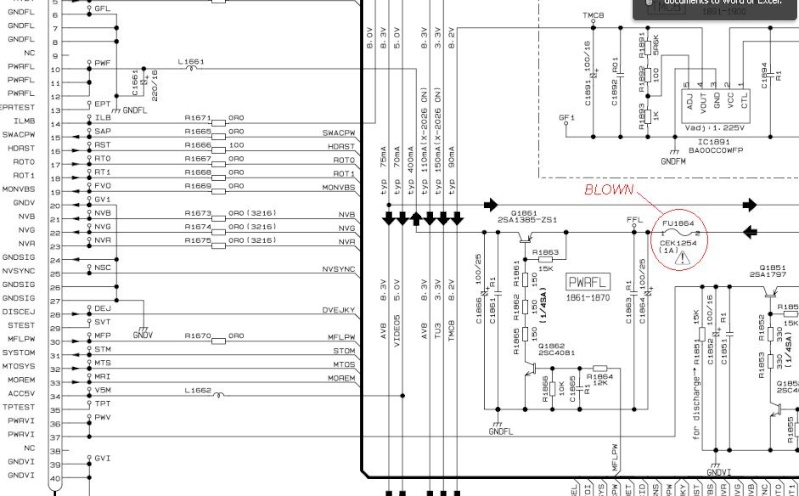

I decided to test the voltages on the monitor board and found all voltages to read low. The 5v regulator had no input so i traced it back to the main board and found a blown SMD fuse rated at 1A. I have uploaded at snap shot of the circuit diagram. FU1864 was blown and i have checked C1863 and C1864 for short circuit but both test ok. I will continue testing. I have to order some SMD fuses but while i wait can i solder in a larger 1A rated fuse to test the circuit?

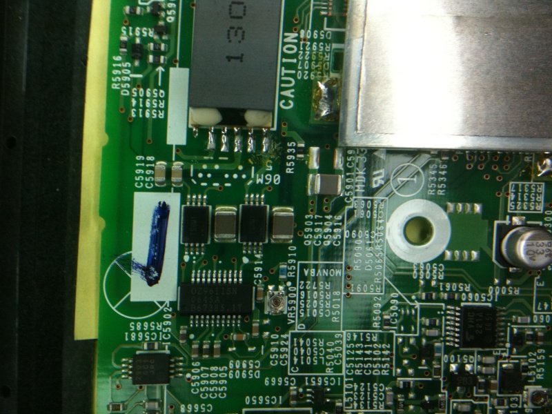

Here is a picture of the inverter circuit (not much use)

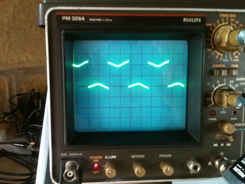

Here is the output of the fet Q5903 after the capacitors. I measured it at the transformer pin 3.

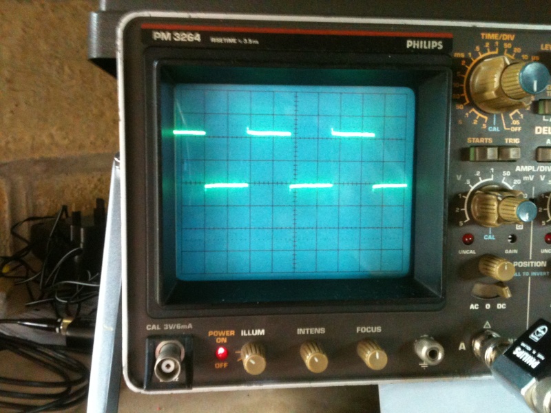

Here is the output of the other fet Q5904 which has no capacitors in circuit. i measured this at the transformer pin 5.
The scope is set to 0.5v per division but my scope probes are x10 attenuated so thats 5v per division. The time base is set to 5µs per division.
The signal can only be measured for a few seconds at power up when the back light briefly comes on then turns off and won't come on.
