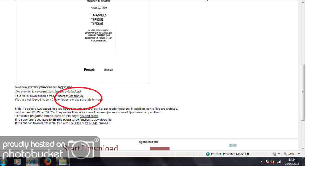

ok so been doing some digging around and been advised it is probably the y-sustain board,
middle of bottom pic post #6
any ideas if this sounds right, thinking of removing it and testing some of the componants?
