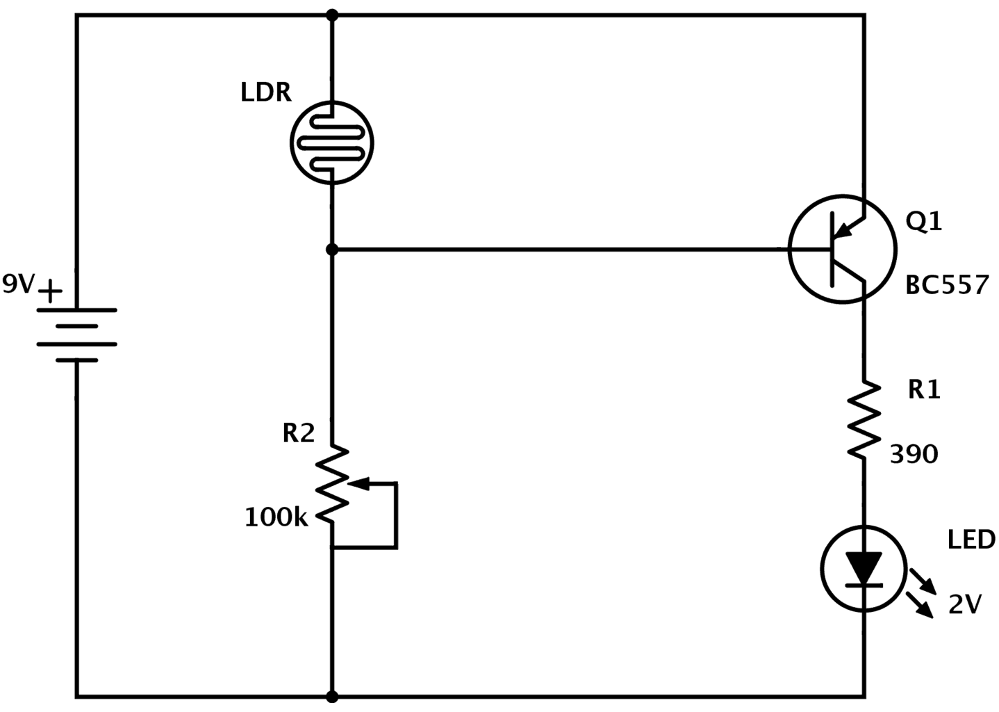

Hi everyone! I'm trying to make this circuit I've found on internet.
I've modified the circuit by using the following parts:
My problem is this: My BC557 transistor gets too hot when I turn on the circuit (and after few seconds it breaks). The LED stays also on all the time and when I change the value of the potensiometer's resistor, nothing changes. Do you know what causes this problem and what to do so that the project will work fine? Thank you very much.
- Power Source 5V (and not 9V)
- Resistor R1 = 6.8 Ohms (and not 390 Ohms)
- 1W LED with forward voltage at 3.2-3.4V and forward current at 300mA.
