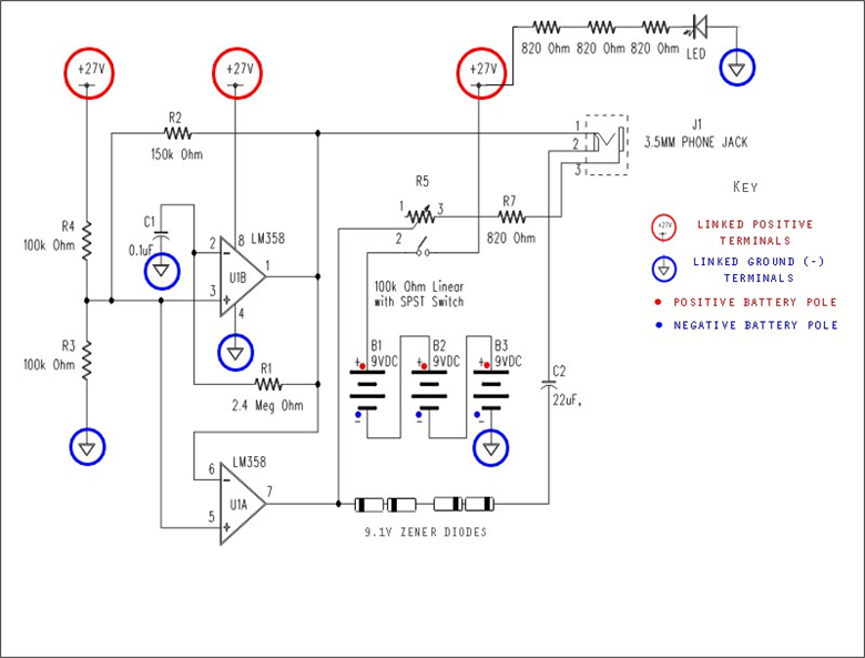

I have this circuit design which outputs about 27 volts at 4hz square wave. What I need is to still output 27 volts but a 10hz square wave.
How do I take this circuit, given its already built, and modify it to output what I needed?
The LM358's are Operational Amplifiers
