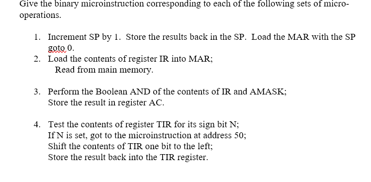

Given this it is so hard to understand please someone solve it for me so I can understand it better.

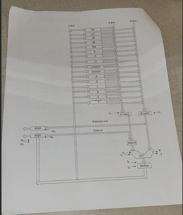

How about the first one. SP++. What does the question mean? How does it relate to the figures, first & second?

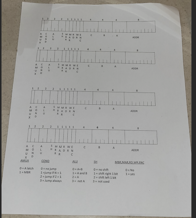

I understand it partially, so for the first one i understand that the amux is 0 cond is 11 and alu is 00,00 for the shift, 00 for the mbr, mar is 1, read is 0 write is 0 , and enc is 1, i got 0010 for c , 0010 for b and 0011 for a, address is 00000000, that is all i understand I think im wrong in some parts of it.

It appears to be just an exercise of going through each step, one by one and assigning the correct values to route the right registers to the ALU and back to the correct registers. Just as in any problem for setting digital muxes as in creating microcode to do operations.
Not trivialising your problem, just saying; follow the steps, it is likely to work and not take too long.
PC<<--- PC+1. I'd guess you set the mux values to route the PC to the ALU, to also route a "1" to the ALU and to route the result back to the PC.
