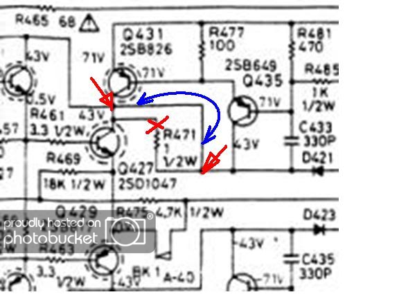

There are NO SOLDER SHORTS ACROSS R-471 and R-472!
And no other shorting method that I can see that might accomplish the same thing. (A) the center current adjustment went just fine
but now I'm stuck at (B) the Idle current adjustment because I have no idea what to do at this point.
Should R-471/2 which were not shorted when I received the receiver, be shorted to accomplish the "Idle current adjustment?(..and shorted how?)
