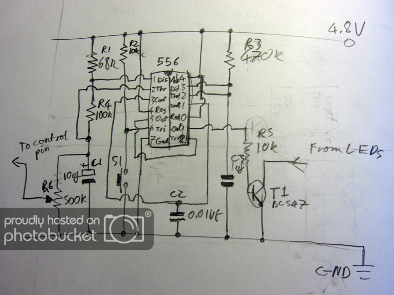

What isn't working fine is my attempts to utilise the control voltage pin.
This is what I cooked up for that. (Sorry, it's an even messier drawing than last time)
The right hand side is a fairly conventionally configured monostable, driving a NPN transistor that will be connected to a number of small LED clusters.
It's meant to be triggered by the falling clock pulse from the left hand side of the 556 and flash the LEDs for about 0.5 sec.
The left hand side is also monostable, although I used a RC layout closer to that of an astable configuration with R4, a 100k resistor, between the Discharge and Threshold pins because I wanted the capacitor to discharge more gradually.
This is because I'm trying to use the voltage in C1 to drive the control voltage pin of the astable 556 that's running the 4017s, via the 500k adjustable resistor R6. R6 is supposed to serve two roles - a voltage divider to allow control of the maximum voltage at the control pin, and also to reduce the rate at which C1 charges as it approaches the threshold voltage, thus resulting in more of the charge cycle being in the high end of the voltage range (making for a more pronounced effect on the LED chase speed).
This seemed simple enough - as the voltage in C1 will max out at the threshold voltage of the 556 I was trying to control (both 556s being controlled from the same battery pack), the control voltage it supplies should be proportionally correct even as the batteries discharge.
... nope. Even though Pin 1 (discharge) is at 0V to ground (when the monostable isn't triggered) and should be earthing C1 and Pin 2 (threshold), they're constantly hovering at 2.4V, briefly jumping to 3.2V when the monostable is triggered.
Pin 9 (Right output) is also constantly high, rather than only being briefly triggered by the falling clock pulse from Pin 5. It will turn off in the instant that Pin 5 (left output) goes high when it's triggered... but that's the only time it's off.
It is marginally possible that I've managed to cook the 556 (my first attempt at assembling the circuit failed to connect C1 and C3 to ground - D'oh!). I have a spare, but I'm not planning on plugging it in just to find out I've cooked that as well.
Should this circuit work for providing the control voltage, or have I screwed up mega style?

Internally the 555 has a voltage divider made of three 5k resistors.
The top is connected to Vcc, the bottom to ground, and the two taps used for the threshold voltages for the comparators. The control pin is connected to the uppermost tap on the voltage divider.
Because the impedance at this point is effectively around 3k3, your attempt to alter this voltage from a very high impedance source (the 500k pot) is doomed.
The voltage going to the control pin needs to come from a much lower impedance source.
Ah! Yes, I kept looking at the internal circuit diagram and thinking that the way the control voltage was delivered to the comparator didn't actually look like it could override the internal divider's voltage, but that just didn't twig.
Right, that explains a lot, I shall go away and rethink...
Right, having gone away and thought, I'm thinking about just overriding internal voltage divider in the astable 556 that's driving the 4017s, and thus supplying a voltage by a slightly indirect manner.
Connecting the control pins to the supply via a 1 kΩ resistor (with a series switch) widens the range the capacitors have to charge through, but I can then retune the potentiometers to get the circuit back to the right frequency. Switching off/disconnecting the 1kΩ then causes the 556 to jump to a higher frequency, much as I want.
(I considered pulling the control pin down towards ground, but my thoughts are that the 556 would probably start acting up if I pulled it as low as I'd need to get the desired frequency - I'm not that far above its minimum voltage).
I could just about put up with the completely effect work if I had to (although the possibility of replacing the grounding capacitor with something beefier should be a possibility to soften the effect?), but I'd like a more gradual transition... and with that in mind, I'm thinking about voltage controlled resistors, which starts to sound like working with JFETs.
I've read around a bit, but I've not worked much with FETs of any type before, so it is getting outside my normal expertise... and I know I might be going off on a daft tangent again.
So would JFETs help me rescue the principles of the above control circuit (driving the JFET, rather than the control pin directly), or do I need to rethink entirely about how to supply the variable voltage?
EDIT: Actually, the quick and dirty solution with a 10-100 μF grounding capacitor to soften a blunt switching of the 1kΩ resistor might actually do the job...
