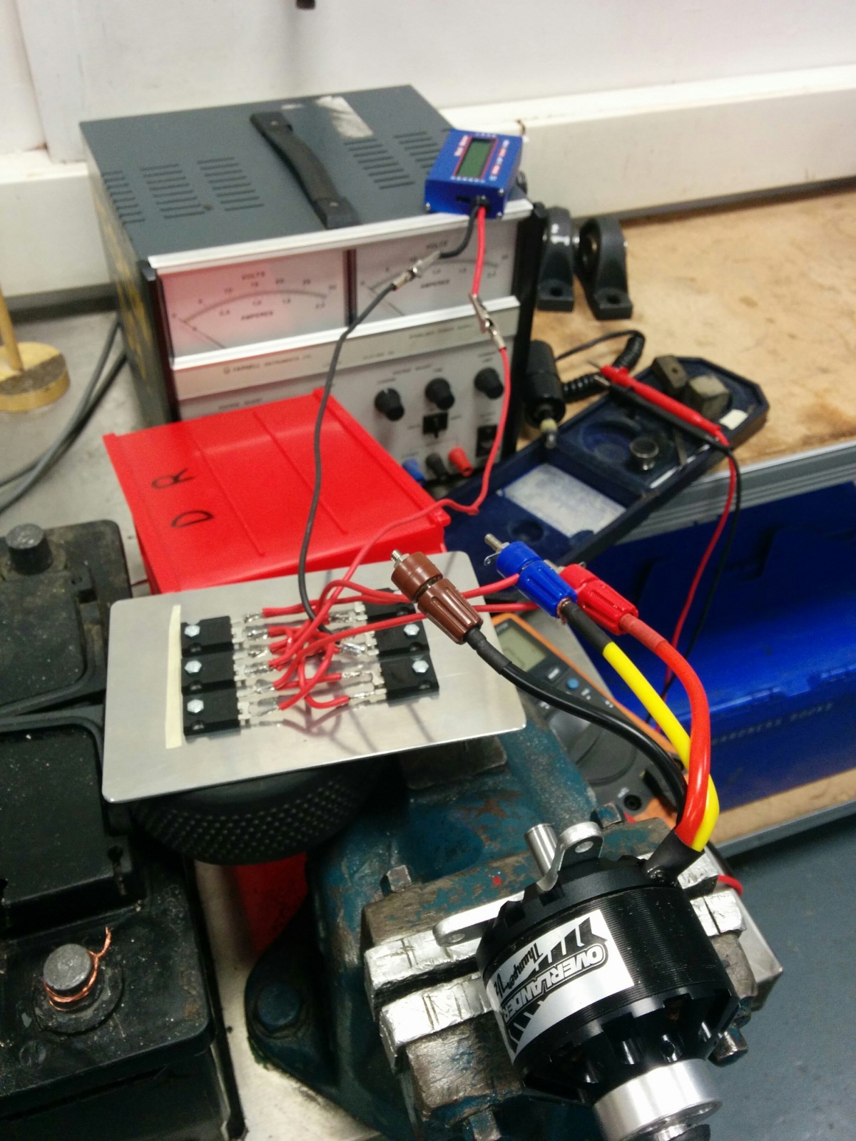

Here is a photo of my set up and rectifier.
The rectifier is connected to a power meter then after that a small 12V dremel as a load

Have you got the diode bridge connected correctly?

Check the circuit again. There should be three anodes connected to one output and three cathodes connected to the other output. Each phase should connect to one anode and one cathode. A neater layout would make it easier to see.:)

The bridge diagram as shown is correct but when the diodes face each other on the heat sink, the anodes will be on the right on one row and on the left on the other row. The amount of linkage wire should be minimal.
Have you got this right?
The positive output will be connected to three cathodes and the negative output will be connected to three anodes. There is no need for several crossing wires.
Sorry for the huggee photo, the two sides are symmetrical (apart from reversing the anode and cathode) and this is the clearest photo I have.
The reason for the bad layout is they were intended to be placed on a block like this photo below however they were getting warm so decided to fold them out on some sheet to increase the surface are and add thermal paste on the back. The photo below shows a taped up version of the initial idea.
