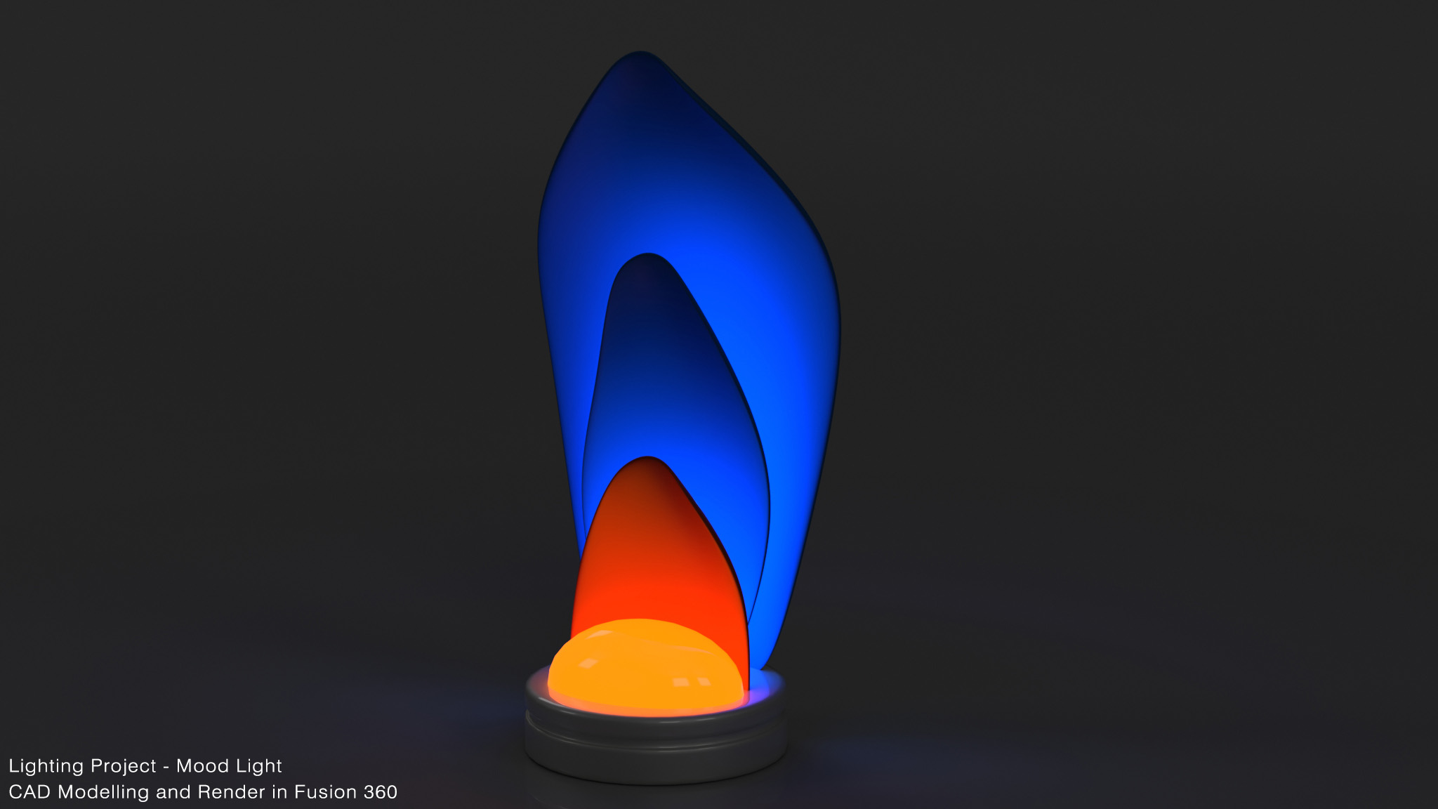

The Final concept Idea ( CAD ):
Basically the LEDs must be located behind each wall, on the cylinder, so the LEDs are not visible, and the sun like object, is just a plastic bit coloured in orange and LEDs are inside it. They can work by getting power from a rechargeable battery which could be connected to a USB source, PC or socket.

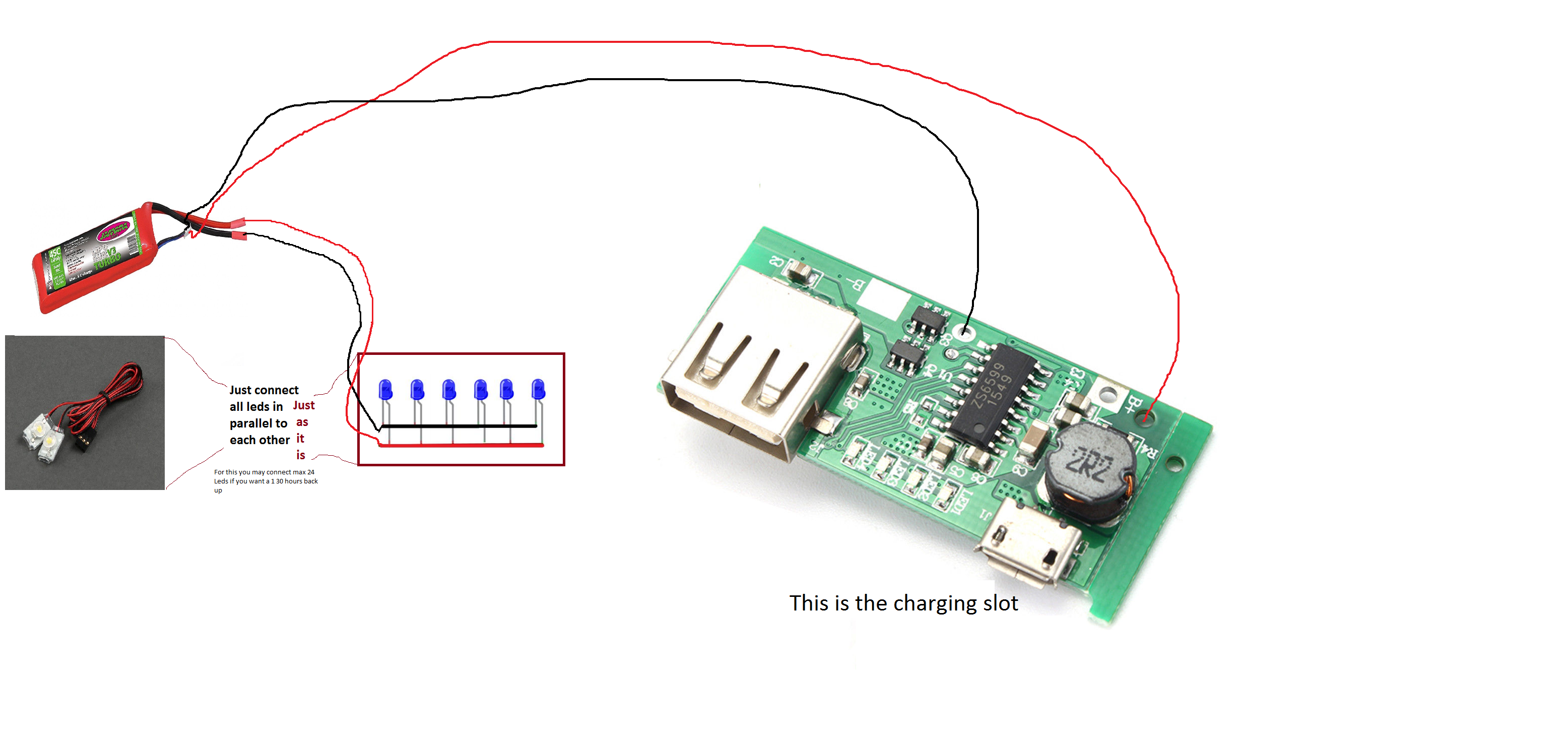

The plan and what to do concept ( LEDs connected to battery and the charging slot, any idea or comments highly appreciated) :
I would really appreciate if you help me to understand if I am on the right track. for example a remote on/off switch.

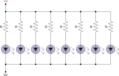

Regarding your image with the six blue LEDs, the battery, and the charger... if you actually read the resource here on LEDs, you would realize that you NEVER want to wire LEDs in parallel:
ledpar-gif.12787
Each LED needs to have its own series-connected current-limiting resistor:
parallel_leds2-jpg.12790
So sorry I did not mean to attach links, I just copy/paste the names here.
Regarding the diagram, I just removed that because I bought other parts, and got one 5W ceramic resistance as an experiment for now. surly will use 1 per each after the experiment.
