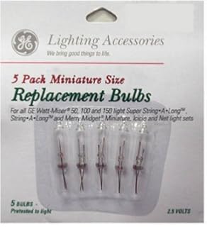

I have a set of 2.5 volt tree lights with a few bulbs burnt out.
I have replaced several and have some working but some refuse to co-operate.
The sockets have been tested at 2.2 volts, the bulbs will light when 2.4 volts is supplied directly to them and when I connect the bulb leads directly to the contacts inside the socket it will light the other lights in the string but it won't light the bulb itself.
http://ecx.images-amazon.com/images/I/41Z3M4RAQAL._AC_UL320_SR292,320_.jpg
Perhaps you have a fault in the socket. Inserting the bulb may be causing a short-circuit across the socket.
Thanks for the response Alec.
I'm convinced it's the bulbs.
I can take a working bulb and put it in a socket where the bulb doesn't work and it lights.
It sounds like the replacement bulbs want more current than the originals. It could pass a small current without lighting. Can you test and original bulb and the replacement for current draw at 2.4V?
The voltage for the original string is 2.5 volts and the replacement bulbs are 3.5 volts.
What was confusing was the 3.5 volt bulbs were operating on there own with 2.5 volts but when put in with the rest of the string some would work and some wouldn't.
I'll make sure the replacement bulbs are .5 watt and 2.5 volts.
You didn't say the wattage of the 3.5V bulbs, if it's much higher than the other bulbs you may have your answer.
