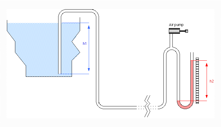

What about a non-electric gauge, such as a pneumatic system with a 'U'
tube?
In case you have not come across the system, I have drawn a diagram at:
http://www.poppyrecords.co.uk/other/images/Gauge.gif
A hand-operted air pump is used to fill the tubing with air until it
bubbles out from the dip tube in the tank. If the fluid in the
manometer is the same density as that in the tank, the height 'h2' will
be equal to the height 'h1'. If the two fluids have different
densities, 'h2' and 'h1' will be related by the density ratio.
When you fill the tank for the first time, calibrate the manometer as
you go. The calibration will hold good for all time and the system will
work with no need for batteries until the pump washer needs replacing
(about once every 25 years and cheaper than a battery).
