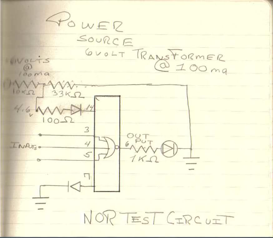

I'll post the test diagram later.
You have pull-up (or pull-down) resistors on your inputs? Right? No input should be left floating anywhere on the chip. If you're only using one gate tie all other inputs high or low. Your input voltage is fine according to the datasheet. Being fed from a voltage divider sounds a bit dicey but I'll hold further comment until you post your schematic.
You seem to make contradictory statements regarding gate behavior so I'll just remind you the output will only ever be high if all three inputs are low. If you have your LED wired from your 4.6 divider to the gate output that would explain it's apparent inversion.

I think I just realized what I've been doing wrong.
I'm using only one gate, that means that 8 pins are left ungrounded.
I'm thinking about just using a voltage regulator Mosfet, and abandoning the whole voltage divider thing
Hear is the test Diagram.

Yes, that power supply scheme is rubbish, it couldn't possibly work well from that - even driving a LED too. You'll need a proper voltage regulator. Unused inputs = high.
alright, I have a single nor gate working nor, all I had to do was ground the unused pins.
I also have a 7805 supplying a constant 5volts.
