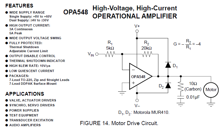

i am trying to build a linear analog servo drive for a servo motor and YES it is analog not a PWM for many reasons one of them :is that this drive is a part of control system i am working on and i want to reduce the noise to minimum.

3-is this circuit correct to control the motor position in bi-direction?

That circuit looks OK. You will need a power supply of about +-7V to limit the motor voltage to 6V.
I have not looked up the data for the amps you mention but I have used a LA6500 (1A Maximum) for non audio purposes.
The DAC must be able to produce positive and negative outputs or you will need a level shifter.

can this be useful?
