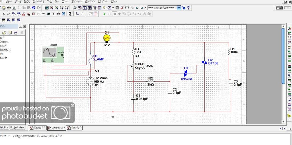

No, this is only a part of a bigger project. the other part are good to go. i just have problem with this light dimmer part. the parts will be joined using PLC.
Basically my project is a sleep mode initiator. when a person lays on a bed, the pressure will trigger a lots of things to fit in the 'sleep mode' ie light dim, close curtain, adjust the aircond etc.
i need to buy all the parts and built it when i finished my presentation next week. no borrow. will go buy when i have a definite circuit. Budget wont be a problem. i have prepared it all.
As for the light bulb, an normal 12V, 60W will do.
but it doesn't matter really, i will buy components according to the final working(simulated) circuit. (if light bulb simulated as 100W, i will find that one)

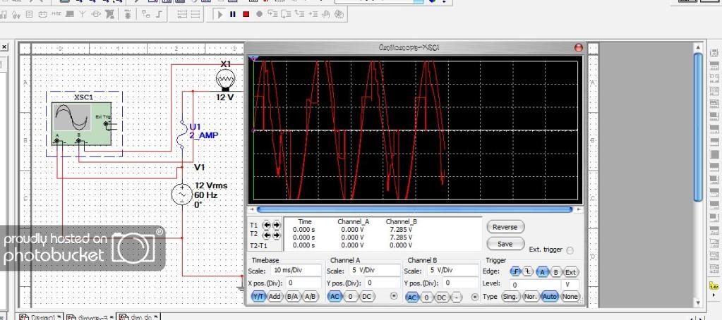

Do you think this circuit is poor? not good to go? should i try the one with MOSFET?
