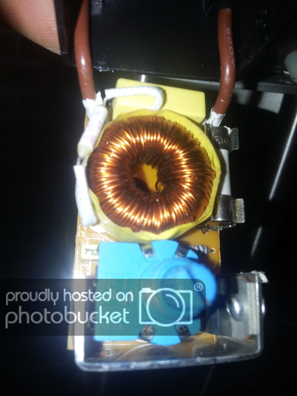

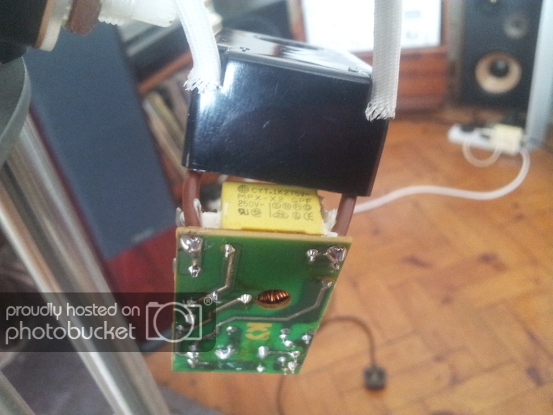

So rooting inside I find the switches . Taking the dimmer cover of and using my volt probe , I detect voltage coming into the dimmer ,inside it , but none coming out . The guy who sells new dimmers of this make ,bless , £20 each , was helpful enough to tell me that there is a safety feature in there .
Now I realise the yellow capacitor at the top is a thermal overload/tolerance item , so I was hoping I could find a cheapish one at Rs , or likewise , to replace it with ?
Of course ,it may be something else , but I all seems to point that way ??
What do you experts think ,If I may ask?
The fuse at top right is good by the way !
I also had considered just replacing it with a straight on /off ,as I doubt I will need to dim it ?
