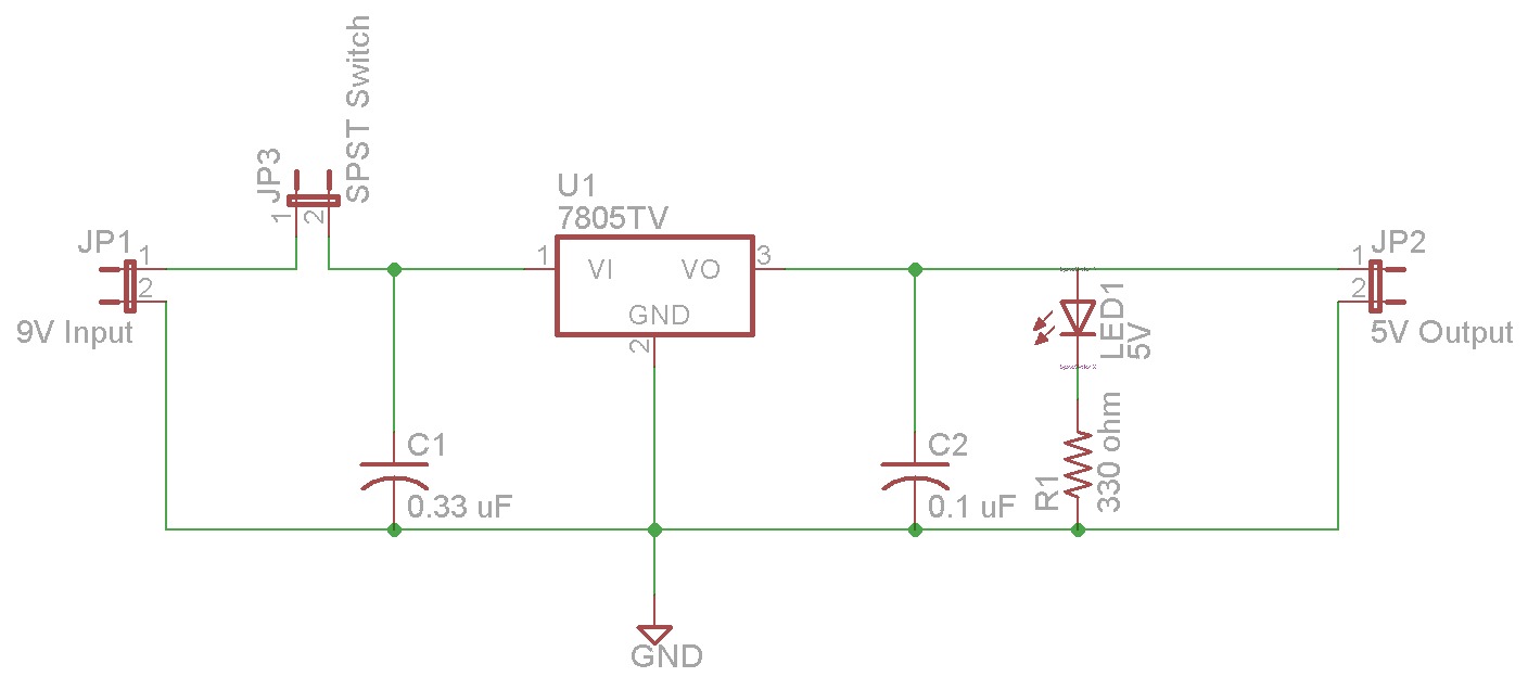

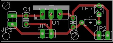

Thanks for the reply Adam! The only schematic I ever created of my own was a very common 9v to 5v converter. Past that, I don't really have any ideas. I've been handed hand drawn schematics for capturing/layout before but never had to create my own. Is there a circuit that you've always liked that would be good for beginners to research?
My first project was this:
