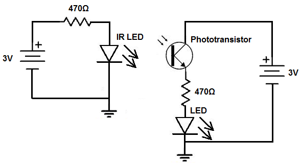

Would a simple circuit be enough? I would a switch to the transitter circuit to turn it on. Also add a relay to the receiver circuit.
No, those are 38KHz receivers that require a lot of active electronics to use, typically a microcontroller.
