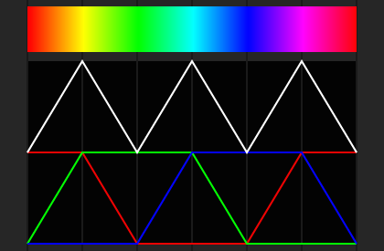

This is the rgb variables the led gets. I'm wondering if by adding a capacitor the values will change to the output of the capacitor?
I don't have any at home zo I can't try it out...
The last thing is not a option. I'm taking the led from the led controller...
