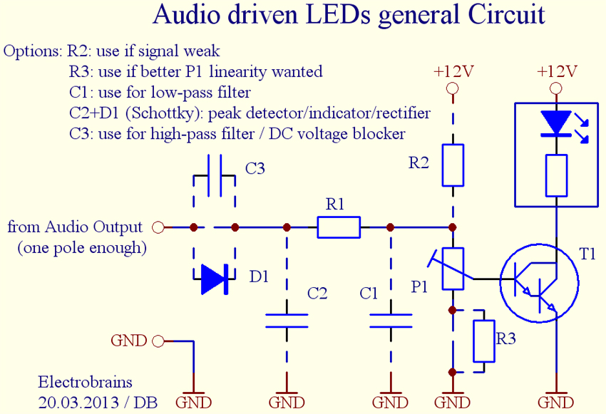

A little background first:
All I'm trying to do is attach some 12v LED strips to the speakers in my car such that they will flash to the music. I attached a drawing of the circuit I did in Paint that should describe what I'm doing, but essentially, the +/- of the speaker wiring (post-amp) is directly connected to the +/- of the LED strips, and a toggleswitch is added, as well as a low-pass crossover so only low frequencies (bass) will be detected by the lights, which are in series.
I did a test run on one LED strip to make sure everything is okay, and it actually does work. The only problem is I have to turn the volume way up on the stereo to get them to light up. I used a multimeter to troubleshoot and found out the voltage directly before the LEDs is too low. (As mentioned before, the LED strips are rated at 12v.)
So, to finally get to my question for you guys: Is it possible to "boost" the voltage so the lights will flash at reasonable volumes?
Thanks in advance for any advice you guys can offer
