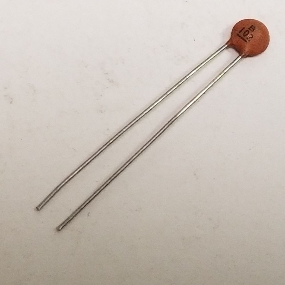

Greetings. I am trying to identify this ceramic capacitor (orange in colour) that I have to replace on the PCB of a power board to my radio, the schematic says 102 on it and that's it, I found a code guide on Google but it seemed to be different, however the capacitor has this 102K on it, and a B on top, so I assume that it is 1000pF because the 2 gives you the number of zeros + the first two digits, I think the K means that the Tolerance is ±10 %.
I'm a bit confused about the B on top of The 102K , what's that for?
Please, if anyone can confirm this (I found a picture of the capacitor on the internet that looks exactly like it except that the K is absent beside the 102, it is attached here)
