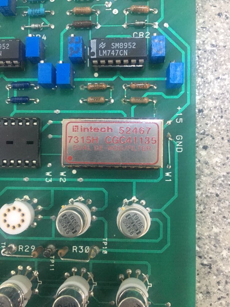

I am looking for intech 52467 7315H CGC41135 DUAL DE-MOD/FILTER integrated circuit. Is there anyone who assist me to find it or the equivalent one?

Do you have the datasheet for the original device?
That looks like an in-house numerical designation, I certainly can't find any reference to it.
Those are the photos og it. It is Textron test device for tank stabilization.
Thank you for your help
Is that a label stuck on top? If it is then there might be something under it that helps.
But it looks suspiciously like an ASIC to me (application specific) so the only source would be the OEM.
It is not a label stuck on it. It is out of production so it is impossible to find the oem. There might be the equivalent one (I hope :)).
I think you're completely stuck then. Without a schematic to determine its operation you can't even 'guess' how to replace it.
