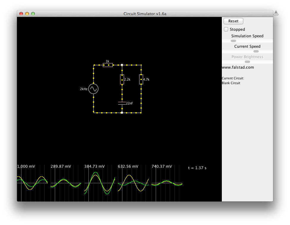

So I'm doing an assignment and it requires me to draw the phasor diagrams for the circuit below. I need to draw the phases for each of the components, with the voltage source being the reference phase.
So I understand what phasor diagrams look like, but have no idea how to actually draw them. I've got all the values for the components, so what calculations do I need to perform? How is this translated onto a diagram? I've tried looking online but nothing that says "Ok, using your values do X then Y etc".

Next step is to name the components. THis will make the following calculations easier. For example name the top left resistor R1, the 2.2k resistor R2, the 4.7k resistor R3 and the capacitor C1.
You should also clearly label the currents in and the volatges across the components. E.g. name the source V0, the voltage across R1=V1, the current through R1=I1 etc. Take care and note where the same current flows through two components (e.g. I2 through 2.2k and 22nF) or where the same voltage is across two components (e.g. the voltage across (2.2k+22nF) and 4.7k). Same currents have the same name as do same voltages.
