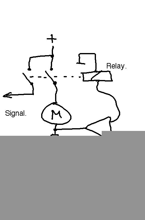

I try to build a simple system that cuts off the power from an electric motor (small, DC motor) when there is too much resistance/work/friction ...
I guss the idea is to put a small resistor and that way measure the electric current. The best would be to use a relay, that would fit some other things, too.
But ... I'm really not good designing anything so all help are welcome! I understand the idea behind this but I need help with the basic design. As simple as possible.
I'm trying to develop a system where I have several small DC motors running. Each one can be separately stopped by slowing them down enough. The plan is that I get a signal from each when they're on/off.
Something like this (see the scetch...)
Any idea or design for a simple system?
Thanks in advance, all ideas welcome!

Right now I think I make something like this: Resettable fuse and that's it.
Again...no details! How many motors? What voltage and current? What starts the motors? What happens after motors stop? What power supplies are available.........?????? If this is going to be one of those projects where you want to keep it a secret, but you want someone to solve for you...I'm done.
ken
One motor, voltage 3 - 12 VDC, current around 0,5 A, starts by switch. When motor stops, nothing happens. Power supply is separate has nothing to do with this circuit.
Nothing secret, nothing complicated either.
I thought my fine scetch told it all :)
OK, so there will be several duplicate motor circuits. Is the motor spec'd for 3-12V/0.5A, or are you supplying 3-12V for variable speeds? This is the supply I'm referring to. This also brings up what supply is available to power the electronics. Do you know, or can you measure the starting, running, near-stall, and stall currents at whatever voltage you are supplying to the motor. Per Steve's concern, are you going to shut this detector circuit off at start-up? Will all the motors start at once? At some point do you shut all the motors off together, or individually?
Basically a sense resistor, comparator, delay/latch, relay...but the devil's in the details.
Ken
The plan is to make several, identical but individual systems. In each system one motor and controlling unit. All work with DC propably from a car battery or some other source.
The voltage is depending on what motors I'll find. No other criterias. One speed.
Yes, same power to the electronics and the motor.
The current used in the start I thought to skip by a delay. I mean, in the start 1 sec delay and after that this current monitor steps in. Sooner or later each motor will shut.
I have tried now find some good ideas for the electronics but it might be to tricky. Now I have started to design again - bummer - a semi-mechanical solution. Something where a micro switch controls the motor...
I hope someone comes with a good and simple idea before that :)
ps. I already have mechanical systems, they work great but after 10 yrs using not much longer... These works like this: all units starts when I switch on the power. Individually each machine can stop if it is breaked down (slowed down enough). This is done by a micro switch, when the torque twist the motor enough against a spring. The micro switch cuts the power from the motor by a relay that feeds itself. This way the motor do not start before the mainpower is resetted. From the relay I also get the signal if any motor is running anymore.
This system works great but it's time to build a new one. It's already 2010 :)
