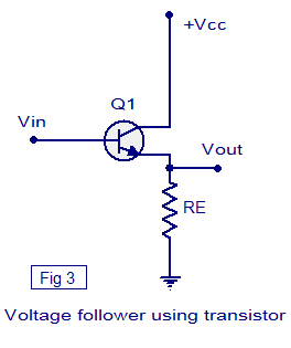

Like this ? How is Re set ?
The voltage follower works well. Re=100K yields 15MΩ loading to Vin with a 150beta 2N2222A. No more overloading of the triangle wave. Output is near desired range.
What would be the effect of adding some resistance to the collector ? Would it produce less or more attenuation at Vout ?
As long as you are taking your output from the emitter, adding *reasonable* resistance (not 1 ohm, not 1 Meg) to the collector leg will not affect the output. It does shift some heat from the transistor to the resistor.
Note that your circuit has a *very* asymmetrical output impedance. Pulling the output up is at a low impedance. Pulling the output low is the 100K resistor.
It sounds like the -0.6 V shift in the output waveform is not a problem for your application. If it is, there is a relatively simple way around it.
ak
The output impedance will only become asymmetrical when the transistor current has reduced to zero so will depend on signal amplitude and load.
