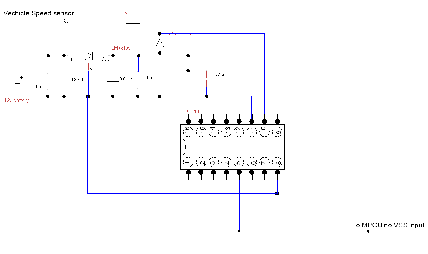

With the help of some electrically inclined people, I have come up with the following, to divide by 16:

Yes, that looks good.
I have two suggestions:
The 0.1 µF decoupling capacitor must be connected as directly as possible between pins 16 and 8. It's a good idea to show it like that on the schematic, to remind you when you come to build it up.
You can use a CD4024 or 74HC4024 instead of a CD4040. It's slightly smaller.

Many thanks! I will update the schematic to remind me! Thanks for your help.
