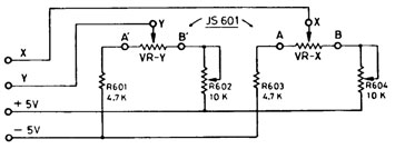

I found the actual schematic of what's inside there.
http://www.o-sd.com/misc/vecman-21.jpg
The pots are 10k.
I still haven't figured out how to do it. :(
get a busted one and replace the pots.
I made a joystick once, got two pots tied the spindles together
at 90 degrees, attached one pot to a bracket on the base
and the other to he stick.
It did the job, (got me through galactix)
there's a way - I think you'll need either exponential and log amplifiers
stages or a pwm stage, I don't think the correct transformation can be done
using only linear combinations.
I think It's beyond me.
Bye.
Jasen
