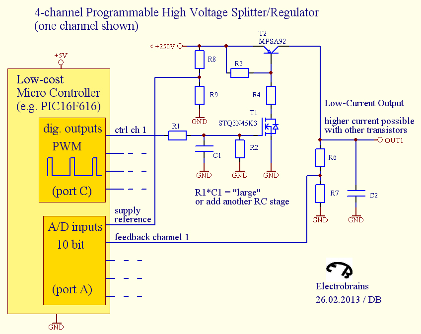

My idea is a low-cost, compact circuit with "adaptive voltage regulators".
As I understand, the application neither demands fast reaction, nor high output power.
The circuit shown below is based on a low-cost uC. It has rather slow, routine constructed PWM or PDM (Pulse Density Modulated) output pulses that are Low-Pass filtered to give a smooth control voltage to a MOSFET transistor. The MOSFET acts as a Voltage/Resistance converter and will control T2, that acts as a linear series regulator.
The output voltages of the channels are brought to A/D converters that will give the measured data for the control loops of each channel (the programmer needs to have some understanding of Control Theory). The dynamic response of the regulators is much influenced by the RC product, that needs to be quite high to be able to filter the PWM signal.
The circuit could work in this way as a programmable 4-channel High Voltage Regulator.
To be able to get the Voltage Splitting function (% of supply voltage), the Supply Voltage is also brought to the uC as a Supply Reference Signal. The uC can then calculate the real Reference Signal for the control loop when the ratio (%) is given from somewhere.
I think this circuit could work well in some applications. It will have a few weaknesses though: The line and load regulations will not be very good because of the slow uC system response. To directly regulate 50/60 or 100/120Hz ripple, for sure you would need a much stronger uC with several built-in PWM modules running at high frequency. In this case, I have assumed that the high voltage power rail does not change voltage very rapidly.
Another concern with this circuit is the rather sharp VgsON knee of the MOSFET (made for switching rather than V/R conversion), that wouldn't allow for much dynamic of the PWM signal. There might be "softer" MOSFETs available, or some further dc adaption could be made to better fit the linear area of the MOSFET.
But maybe the laggardness of the RC filter would be enough to set the operating point in a good way.
