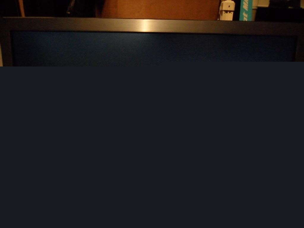

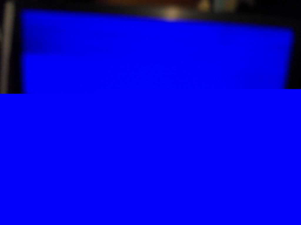

Monitor A - When plugged into a computer, it shows nothing but a blue screen with random flashing scan lines of black, the black lines just disappears and comes back in a very fast continuously motion.

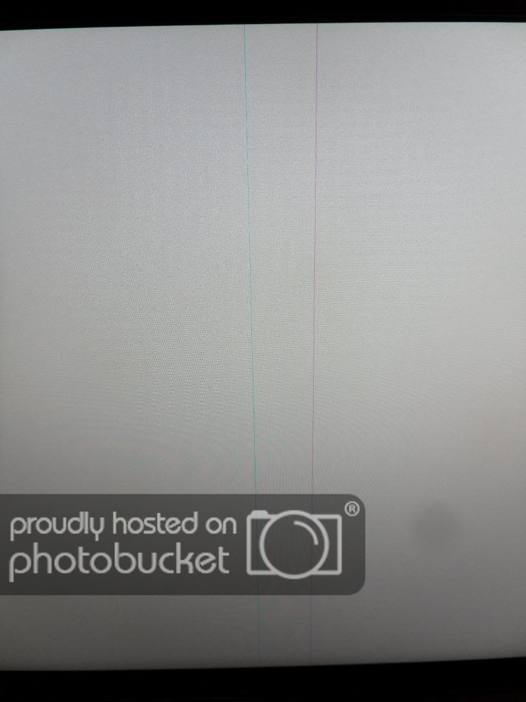

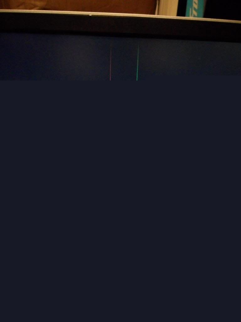

Monitor B - It has 2 discolored lines running from top to bottom of monitor

Faults with vertical or horizontal lines (that don't move) generally indicate a problem with the row or column drivers or connections.
