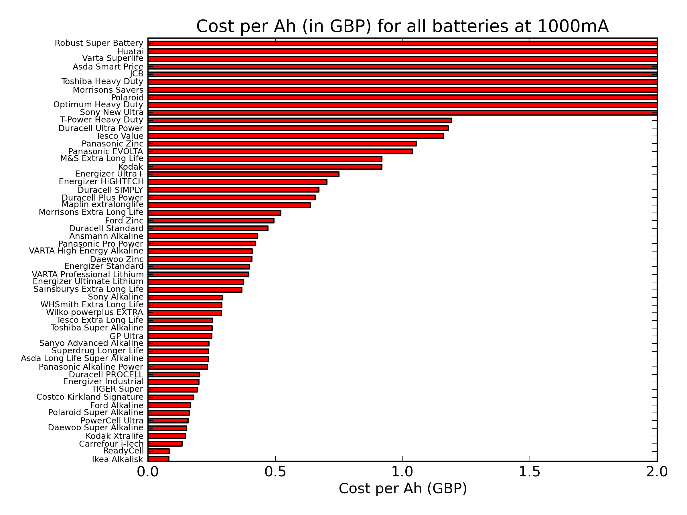

You might be interested in these resources then:
http://www.batteryshowdown.com/results-lo.html
http://www.batteryshowdown.com/results-hi.html
We can 'say' that cheap batteries don't last very long. Although that's very often true, it's not ALWAYS the answer.
Different chemistries last different lengths of time... and some batteries that perform amazing in a camera, won't actually out last the competition in a TV remote control.
The links I shared above show a comparison of 30 different common batteries, This would be the ideal thing to show her.
Additionally... you should be looking at it as a function of cost.
If the expensive batteries cost twice as much, then they should give her twice the amount of pictures.
I'm unsure how many she is actually going through, and you may not want to hear this, but as long as the 'cheap' batteries last long enough for the cost... it's worth it.
I would highly encourage her to keep her eyes out for deals though, and pay attention to how many pictures she can take with the cheap pair compared to the expensive pair.
