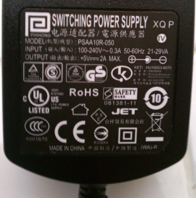

Coca-Cola or anyone, could you please tell me which Output plug would be most appropriate for my Wireless USB Transmitter (based on it's original AC wall adapter)?
I can't remember which plug I plugged it into, I "think" I put it in Output 1. I really worried I might have reduced the life of my Wireless USB Transmitter. *How serious is it if I had put it in the wrong Output?
Anyway, I would like to know which Output 1 or Output 2 is ideal for my Wireless USB Transmitter (based on what it says on the original AC wall power adapter that came with the USB Transmitter:
Here's a picture of the original AC wall adapter:
I can't stop stressing out that I might have somehow caused unnecessary stress or wear on my USB wireless transmitter by possibly using the wrong Output plug.
Either one will work just fine for your USB standard device, as the USB standard only officially supports current drains up to about 1A... So any compliant USB device should use less then 1A... The higher rated output is for things like new phones, that have detection circuitry in them... If they detect a 'real' USB port they will only draw the maximum current within USB specs, basically they throttle down the charge rate... If they detect a charger circuit they will draw more current so they charge faster...
