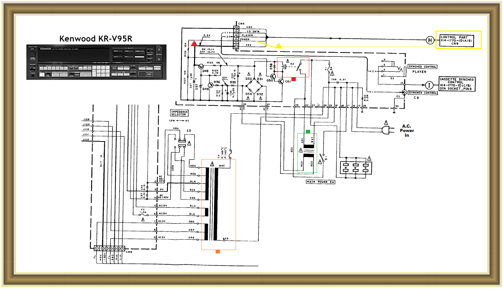

now . . . . . . . .HOWTODITOITINTHEDARKDEEPBACKWOODS . . . . . .
RELEVANT KENWOOD REFERENCING SCHEMATIC SNIPPETS . . . . .
After confirming all fuses being good . . . . and not having any being blowed-ed-ed.
AC power comes in at the right center and routes thru, a hopefully fully turned on switch S1, to the GREEN flagged standby transformer.
It supplies AC to the FWB- E-filter caps and regulator transistors above it and outputs +5.5 VDC frrom the final reg pass transistor of Q48. That RED TRIANGLE flagged 5.5 VDC feeds to the right to the YELLOW control board and if all is well when you attempt to turn on the unit, a small turn on voltage comes back down the YELLOW TRIANGLE line and into the base circuit of Q50 to 51 to activate RED flagged main power relay K2.
The power relay contacts of RED FLAGGED K2 then routes main AC power to the ORANGE flagged main power transformers RED and WHITE primary winding.
Now if all is well, one then checks the secondary windings and derived voltages from the secondary of the main power transformer.
UNLESS there is being a catastrophic failure present in the audio power output transistors section, or its power supply . . . . .in which case the control circuitry will respond by dropping that relay on voltage in an instant of the control circuitry having detected an overload fault .
Then you make a more in depth troubleshooting for shorted AUDIO output transistors, shorted power supply diodes , etc.
Thaaaaaaassssit . . . . .for now . . . .
73's de Edd . . . . .
