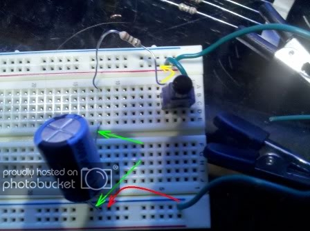

You did not connect the other of resistor to the positive wire or capacitor .We removed connection of push button switch to simplify circuit.
That's the reason that capacitor does not have charge voltage because current path was discontinued or not connected.
Please check if negative wire of capacitor was connected in line with gtreen wire. Use multimeter to confirm connection of wires and components.

I think that your experiment is working properly. The problem is that your RC time constant is too short for you to see it charge up. Try using larger resistors, like a 5k ohm.
Resistance times capacitance equals Time. RC=T. This is the time it takes for a capacitor to reach 63.2% of a full charge. 1/RC= frequency.
First, discharge your capacitor to ground, Then hook your voltmeter from ground to the positive on the cap. Now apply a positive voltage to the cap. and observe the volt meter.

The main thing is to follow instructions. if you look at that pic you have posted above and compare that to the actual pic of your layout you posted much earlier in the thread, I'm sure you will see where you have some gaps in the circuit ;)

When I pressed the button nothing happened at all. Sorry.
As davenn has said, take a look at this picture again. The problem is with the resistor side of the circuit. The photo above looks nothing like the diagram in your book!!! We already showed you a picture of how the breadboard is electrically connected. So fix the switch and resistor according to the book and check the voltage across the capacitor again. Then once it is working, make sure you understand why it is now and wasn't earlier, should be pretty simple to see if you take all the advice given to you.
I did it. I found the solution. Thank you. I just had to try the resistor thing you told me. Yes, I took your advice about not getting four stripes. I also had to reposition the circuit. At the end of the day, I got it to work though. :)
