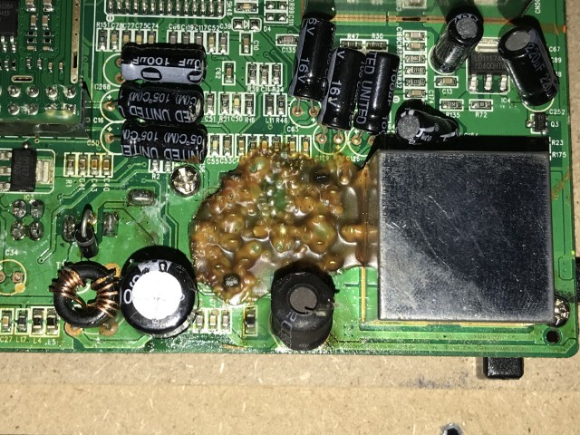

I am having a real issue with a German ‘Dual’ branded DAB radio that has a leak on the board where power cable would plug in. I was told that the wrong power cable (wattage) was plugged in and that it “blew”. As this is a valuable radio, I would like to try and repair it instead of just throwing it away.
There is a dark brown liquid on one part of the board and it also looks like it has bubbled up. This works with a European 2 pin plug but I have also tried with a UK 3 pin one but to no avail. I cannot work out if the leak came from one of the two nearby capacitors or perhaps a plain metal box next to where the leak was. I have some spare capacitors in case and want to buy some alchohol and cotton wool buds to clean it with but hoped someone here might be able to assist (as cheeky as I am for asking) before I try.

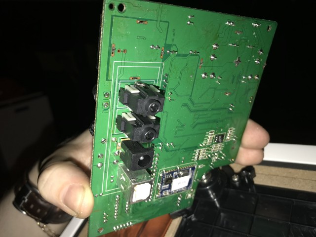

Hi Kellys_eyes,
Thank you for your reply. I have managed to get a photo of the back of the board but I couldn’t find a model number. I did try some of the numbers (in variations as suggested in sticky post) but not sure if there is one. I will send another photo of something which looks like a model number.
I’m just gonna remove the back again now and will post it shortly.

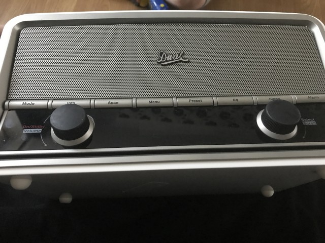

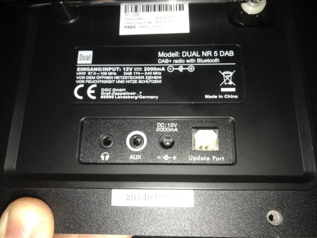

How about a picture of the whole equipment? The make/model is more likely to be on the casing than on the pcb. And if it's not then someone on here may just recognise the equipment from experience....
Hmmmm - the gungy stuff reminds me of the type of gluey stuff they use to hold stuff that's sensitive to vibration - potentially hidden under the metal can-type enclose nearby. It certainly doesn't look like residue from any blown component that I've ever seen 'blown'....
The picture I've attached shows the rear of the power input socket - there looks to be a reverse polarity protection diode beside it (could be a surge suppressor too).
Did you check that the power pack you're using has a 12V output? With 12V positive on the centre pin? and is capable of delivering 2A? Has the correct sized barrel connector? The type of mains lead is irrelevant. If the 12V is present we can discount the power pack as a problem.
We'd need to see some brighter lit close-ups of the PCB around the rear of the power socket so we can trace the tracks to the input power regulator(s) if the above checks prove to be ok.
yes exactly
let me make this very clear .... IT IS NOT A LEAK ... It is supposed to be there for circuit stability of the oscillator section

I’m glad you have confirmed that the gungy stuff is normal. Now I can look into what else it could be. All I was told by the person I got it from
