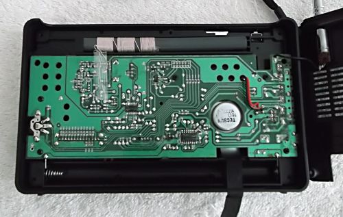

PLUS, if you have been inside of your unit yet, your unit ALREADY incorporates a nice size ferrite rod antenna
inside, only being limited by the cases size.
If you inspect and check, it has 3 spaced Litz wire windings , but with them all being series connected, for a resultant two wire end connection into the tuning condenser. That would only be for the AM bands . Much smaller and different antenna coils, are being needed for 5.6-22.
FERRITE ROD AM BC ANTENNA . . . . . (located at the very top of the unit) . . . . . . . .

Thank you very much for your info and the image. I have just completed the replacement of the ferrite rod. The signal is now bolder and stronger, the only shortcoming is that like other DSP Radio, when the signal weekend, the sound pulses a fraction of a second and resume at a lower level.
