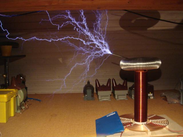

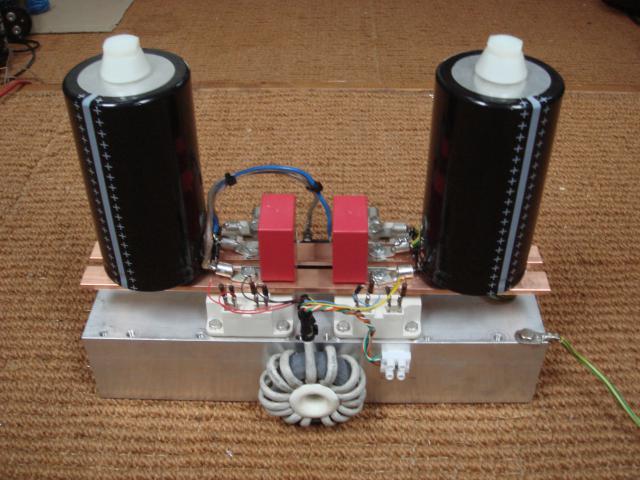

I would like to share with you a small DRSSTC I built last year. Spark legnth is a bit more than 1 meter. The coil is not optimally tuned and I didn't take the time to build it entirely with case and so on, because I'm in the building process of a small QCW DRSSTC at the moment, which will be more fun I think.

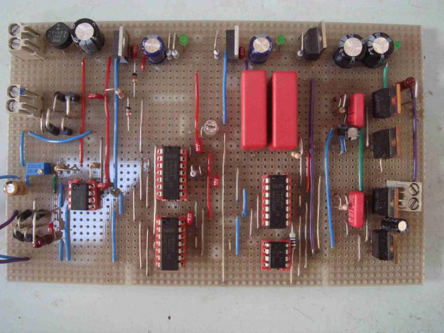

The driver:

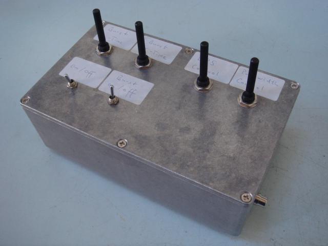

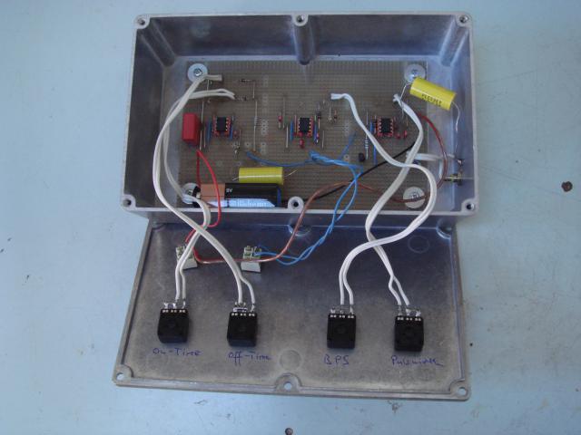

The interrupter:
Power section: Fullbridge with FF400R12KT3 Bricks:

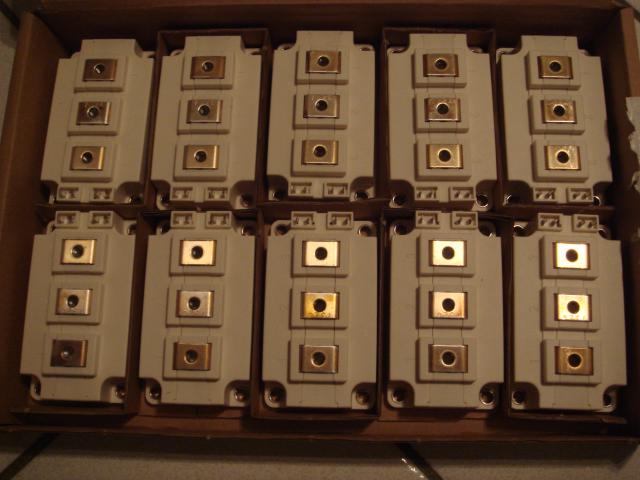

The used Infineon IGBT-Bricks:

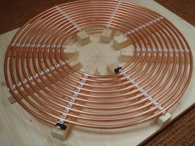

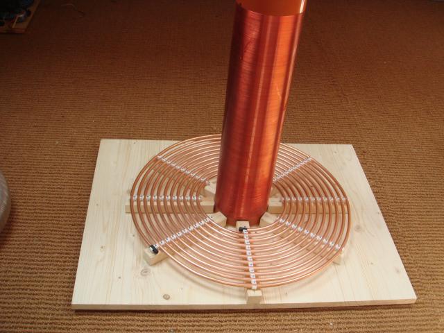

Some pics of the resonator:

Is the top-loading toroid capacitance "hat" constructed from flexible aluminum duct tubing? How is this supported in its interior? Wood? Plastic?

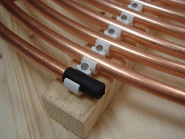

Thank you very much for your kind comment, hevans1944. You're right, the topload consists of an aluminium duct tubing.. In the center it is hold by a round acrylic glass plate (plexi) and some hot glue :oops:. It is not a very good solution, but actually the whole setup is a bit improvised in several ways. For example during longer runs the nails of the white primary-coppertube supports are getting hot due to the eddy currents from the magnetic field of the primary coil and they are melting the plastics holding the copper on the base, so I have to find another way to mount the primary coil.
At the moment I'm building another DRSSTC coil type, so the improvements for this project have to wait until the other one is finished.

You could probably (with a lot of effort!) remove the nails one-by-one and replace them with nylon screws.

I don't know where to get thin nylon screws or fiber glass nails, but you're right, this would solve the problem for sure. Maybe I'll try a solution with cable ties, but that doesn't look very nice.

Yes, indeed. Solid state is coming up more and more. Power-MOSFETs and IGBT-Bricks are being cheaper, faster and easier to drive than some years ago. This year I bought a bunch of IGBT power bricks for very little money from a company, which was producing solar power systems. They had to declare bankruptcy but there was still a big stock of power electronics lying around. They selled it all for peanuts.
