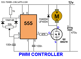

I'm only know the very basics of electronics... I have no idea how to build a pwm circut.
if you want to build it (its very simple) here's the schematic:
but if that's to hard for you or you don't want to build it then here's an ebay link to a pwm controller: http://www.ebay.com.au/itm/DC-12V-4...830649?hash=item3a8db93df9:g:ES0AAOxyUgtTMT6G
