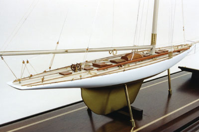

This second picture shows the sheet implementation as I want to make it happen on my sailboat Model!. In this model the technique used in the original sailboat, the Endeavour, is only fake as the sheet that goes from the deck to the boom at the very rear is what really controls the sail. In my model I need to be able to support 8400 mm of sheet length change so that what the next picture shows is achieved!
So this kind of "winch" capable to handle a sheet length change of 8400 mm in a sailboat were the hull is just 1650 mm long builds around electronics to establish a control scheme that uses a stepper motor as actuator. I have created a block diagram while trying to enable others to understand what the hack I was talking about!
