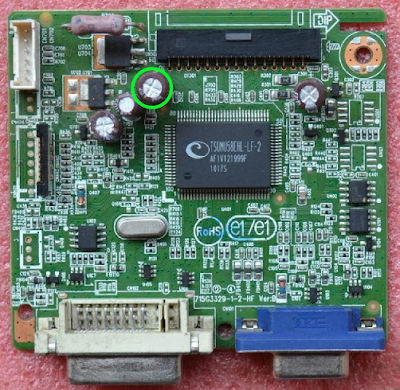

How about either of you that have open viewing access . . . . .passing the capacitive and voltage rating of that unit and its assigned Cxxx designation.
I can make out the C4xx assignment towards the U/P but the nearby power regulators suggest a C7xx assignment.

The failed cap was an Elite 100uF 25v (circled in the pic). There were three on the board and one 10uF 50v. I only replaced the failed cap. The cap showed no signs of failure. I tested with a cheap ESR meter.
